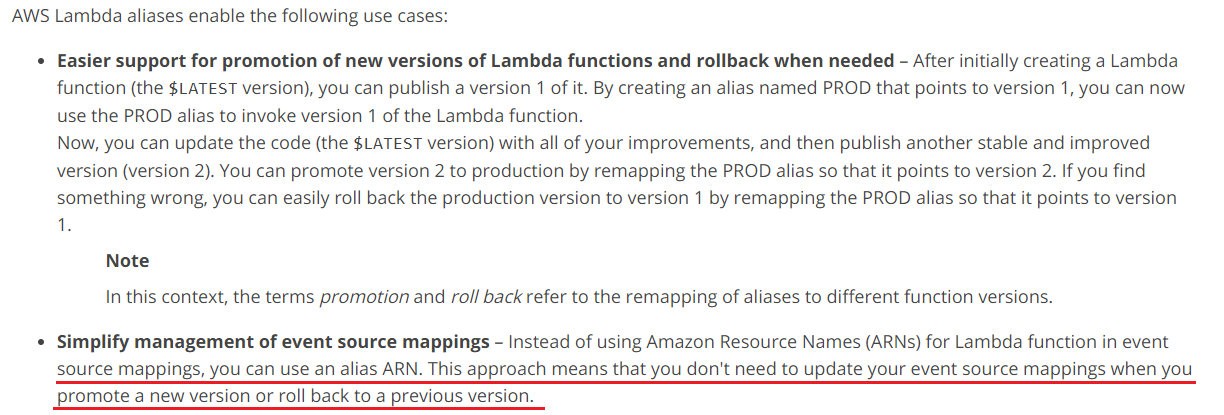

You work for a team which has 10s of applications running on AWS EC2 instances. All these applications would need a common backend processing job. You have created an AWS Lambda function with name “app-backend-job”and published PROD version with version “1” in order to make sure any changes to the function by anyone will not impact the PROD execution code. You have shared the version qualified ARN to all the applications assuming requests would be sent to the specific version. However, due to frequent changes in requirements, you had to change the code of Lambda function many times and keep publishing versions. This is causing a lot of overhead at the application level to update the Lambda function ARN each time you publish a new version. How can you overcome this situation?
A.Create an alias, point it to PROD version and share the ARN with applications. When new version is published, change the alias to point to it.
