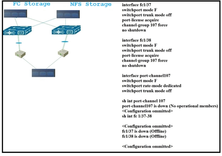

Refer to the exhibit. An administrator must configure a SAN port channel between a Cisco UCS and a MDS switch as shown in the exhibit.
The UCS fabric interconnects are in FC switch mode. The administrator creates a port channel on the MDS switches with the configuration. After performing a "no shut", the interface does not come up. Which configuration change is needed to bring up the port channel?
