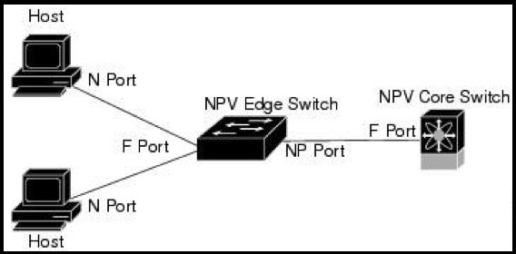

Question 508:
Which statement about the interface that is connected to the NPV core switch is true?
A. The switch that connects to the hosts is identified in the design as an NPV edge switch, and the port that connects to the core is an NP port.
B. The interface that is connected to the NPV switch will need to be configured as an N-Port.
C. The interface that is connected to the NPV core will become an FP port.
D. The link between the NPV core switch and edge will come up as an E port.
